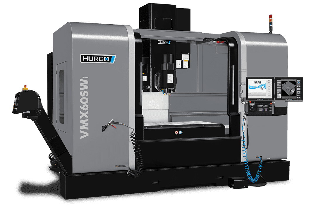

Flexibility-first 5-axis swivel head CNC machines.
Features a tilting B-axis swivel head and an integrated C-axis rotary torque table flush with the surface, providing extra space for secondary operations.
Description
Max Spindle Speed
Tool Type
Table Size
X Travel
| X-Axis | 1524 mm / 60 in |
| Y-Axis | 661 mm / 26.02 in |
| Z-Axis | 610 mm / 24.02 in |
| B-Axis | +92° / -92° |
| Table Size (X) | 1680 mm / 66.14 in |
| Table Size (Y) | 660 mm / 25.98 in |
| Max Weight on Table | 2000 kg / 4410 lb |
| Spindle Nose to Table | 102 mm / 4.01 in |
| Spindle Power | 36.5 kw / 48 hp |
| Spindle Torque | 120.2 nm / 88.7 ft lbs |
| Spindle Nose | 102 mm / 4.01 in |
| Max Speed | 12000 RPM |
| Spindle Taper | CAT 40 |
| B-Axis Max RPM | 50 RPM |
| Tool Capacity | 40 |
| Tool to Tool ATC Time | 2 SEC |
| Max Tool Diameter | 76 mm / 3 in |
| Max Tool Length | 250 mm / 9.8 in |
| Machine Weight | 9900 kg / 21780 lb |
| X-Axis | 1524 mm |
| Y-Axis | 661 mm |
| Z-Axis | 610 mm |
| Table Size (X) | 1680 mm |
| Table Size (Y) | 660 mm |
| Max Weight on Table | 2000 kg |
| Spindle Nose to Table | 102 mm |
| Spindle Power | 36.5 kw |
| Spindle Torque | 120.2 nm |
| Spindle Nose | 102 mm |
| Max Tool Diameter | 76 mm |
| Max Tool Length | 250 mm |
| Max Tool Weight | 7 kg |
| Machine Weight | 9900 kg |
