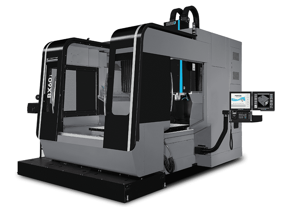

High-speed double column bridge design 3-axis VMC.
A rigid, thermally stable double column mill built for high speeds, tight tolerances and precision applications like die-mold work.
Description
Max Spindle Speed
Tool Type
Table Size
X Travel
| X-Axis | 1600 mm / 62.99 in |
| Y-Axis | 1300 mm / 51.18 in |
| Z-Axis | 700 mm / 27.56 in |
| Table Size (X) | 1900 mm / 74.8 in |
| Table Size (Y) | 1300 mm / 51.18 in |
| Max Weight on Table | 6000 kg / 13200 lb |
| Spindle Nose to Table | 180 mm / 7.1 in |
| Spindle Power | 35 kw / 47 hp |
| Spindle Torque | 118.9 nm / 87.7 ft lbs |
| Spindle Nose | 180 mm / 7.1 in |
| Max Speed | 20000 RPM |
| Spindle Taper | HSK-63A |
| Tool Capacity | 30 |
| Tool to Tool ATC Time | 1.5 SEC |
| Max Tool Diameter | 80 mm / 3.15 in |
| Max Tool Length | 300 mm / 11.8 in |
| Machine Weight | 20000 kg / 44000 lb |
| X-Axis | 1600 mm |
| Y-Axis | 1300 mm |
| Z-Axis | 700 mm |
| Table Size (X) | 1900 mm |
| Table Size (Y) | 1300 mm |
| Max Weight on Table | 6000 kg |
| Spindle Nose to Table | 180 mm |
| Spindle Power | 35 kw |
| Spindle Torque | 118.9 nm |
| Spindle Nose | 180 mm |
| Max Tool Diameter | 80 mm |
| Max Tool Length | 300 mm |
| Max Tool Weight | 7 kg |
| Machine Weight | 20000 kg |
