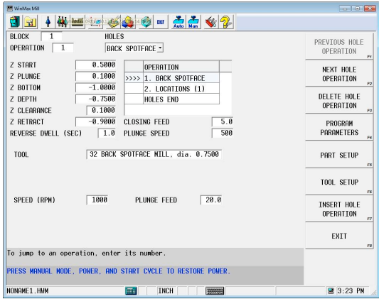

How to use Conversational Back Spot Face Data Block
Click here
to download the PDF Document including screenshots
Z Start- spindle will turn on at plunge feed and will start feeding DOWN at closing feed.
Z Plunge- Once this point is reached, the tool will rapid DOWN to the Z bottom plus the difference between length of cut and tool length in Advance Tool Settings (see images below)
Z Depth- feeds UP to this depth at the plunge feed.
Z-Clearance- Rapids DOWN this amount then reverses spindle
Z- Retract- Feeds DOWN to this position at closing feed, Once this positon is hit Z rapids out of the hole.
