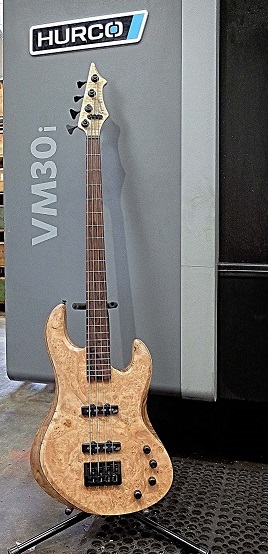

At the Market Overton factory of subcontract machinists Hi-Spec Precision Engineering, five Hurco machining centres and various other machine tools are to be found producing parts from mild and stainless steels, bronze, brass, aluminium and plastic over a single daily shift from Monday to Friday. Nothing unusual there, but the weekends bring a different and unexpected role for two of the Hurco machines (www.hurco.co.uk).
On Saturdays and Sundays, Hi-Spec's owner Darren Grainger and his brother Gavin indulge their lifelong passion for music by milling electric guitar bodies from solid wood. Initially they used CAD files downloaded from the internet but latterly have produced five designs of their own, including one for a bass guitar. It is a hobby that is proving lucrative, as some of the instruments sell both at home and abroad for up to £3,500 under the brand name Grainger Guitars (www.graingerguitars.com), owned jointly by Gavin and Darren.
Gavin said, "To produce the guitar bodies, necks and other parts from wood, we now mainly use a Hurco VM30i machining centre and sometimes also a smaller VM5i, both three-axis models that were installed in 2017. However, we started out two years earlier using other machines and began selling guitars in 2016 at exhibitions around the UK.
"All that's needed is to wipe down the machine table on Saturday morning and block off the coolant nozzles to prevent ingress of sawdust. When we've finished profiling wooden components, we simply vacuum out any wood residue, clean down the machine, uncover the coolant holes and we're ready to cut metal again on Monday morning."
Hi-Spec precision Engineering - GuitarA large and exotic array of woods is used in the creation of the guitar bodies. Early materials were maple, alder and poplar, but lately the Grainger brothers have introduced swamp ash, mahogany, ebony, wenge, walnut, buckeye burl, limba, purpleheart and some wood/resin composites. Pearl and stone materials are also machined on the Hurcos for the marquetry inlays.
Router cutters were used at the outset but solid carbide end mills and ball nose mills designed for machining aluminium were found to produce a much better result, as the sharpness of the cutters virtually eliminates burrs and produces a fine surface finish. It is consistent with the final use of ultra-fine, 2000 grit sandpaper with an average particle diameter of 10 microns to smooth the wooden components prior to the application of multiple coats of gun barrel oil to achieve a lustrous finish.
