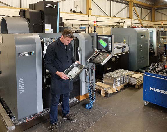

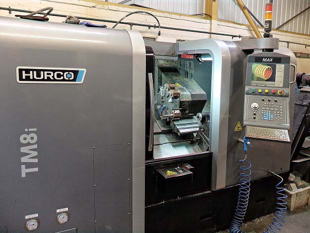

Together with a Hurco VM10 machining centre acquired five years later, these four machines were subsequently traded in for three of the machine tool builder's latest VM10i VMCs. One arrived in 2018 and was joined by two more this year. Additionally, there remains on the shop floor a smaller Hurco VM1 with 4th axis purchased in 2009, as well as a bar-fed Hurco TM8​ CNC lathe that was installed six years later.DW-Engineering-03.jpg​Comparing the performance of the nine-year-old VM1 with that of his three modern, slightly larger capacity Hurco VMCs, Mr Watt referred to an aluminium housing for an electronics industry customer that he has produced in two operations on both types of machine.
On the earlier model running a previous release of WinMAX programming software that included Ultipocket milling routines, total cycle tim​e was 165 minutes. That was before Hurco introduced Ultimotion software to control axis movements on its machines, without relying on hardware-based motion control. It has helped to reduce the cycle time for producing the electronics housing to 120 minutes, a saving o​f more than 27 per cent.

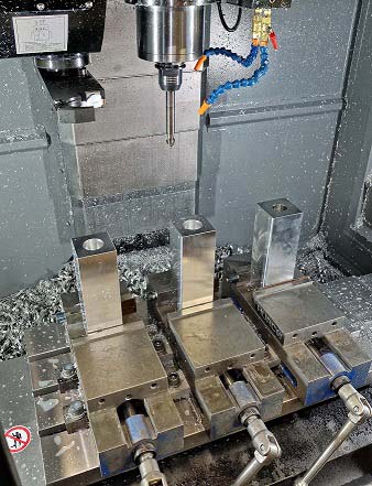

Contributing especially to this increase in efficiency is Adaptipath pocket milling software with its new rest machining routines. The conversational pocketing feature is a module within Ultipocket in WinMax 10, mirroring that used in high-end CAD systems. It smooths the motion of the tool path and keeps chip load between a user-defined maximum and minimum, improving surface finish and extending tool life.
In addition to the two standard pocketing cycles involving inward and outward spiralling of the cutter, Adaptipath includes two extra rest machining routines, zig-zag and 1-way, both of which involve alternate periods of climb milling. The amount of material encountered by the cutter is controlled, often allowing a full depth of cut rather than peck level milling, for higher metal removal rates that Mr Watt said can be up to double.
With rest machining, a larger diameter tool than usual is used after roughing to remove most of the remaining unwanted material efficiently, followed by a finishing pass that automatically swaps the tool for a smaller diameter cutter able to reach areas of the feature that the larger rest milling tool was unable to access. Mr Watt considers this to offer a six to eight fold speed increase compared with previous machining methodology.DW-Engineering-02.jpgLooking back at his company's progress over the past 14 years, he observed, "The variety of materials we are asked to process is vast, ranging from stainless and mild steels through titanium, copper, bronze, brass and aluminium to PTFE, PEEK, acetal and nylon. Accuracies routinely achieved are ± 0.1 mm but some parts have drawing tolerances down to ± 10 microns.
