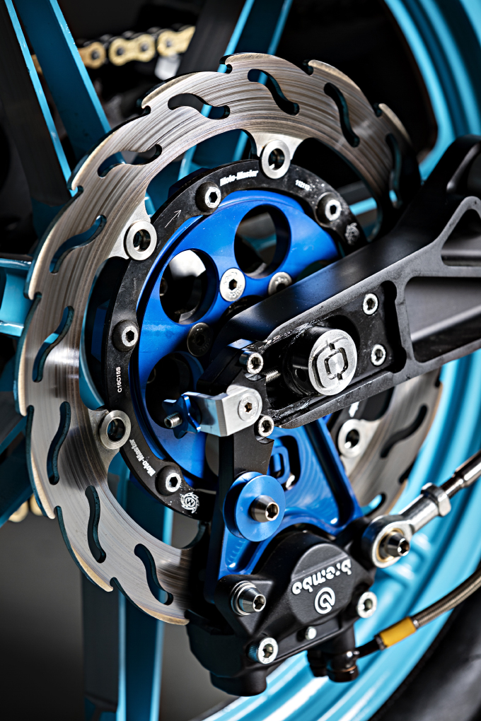

Maxime's first job on the chassis was to install a 19" rear wheel to match the front. He ended up sourcing a second SR unit, and machining it to take a sprocket and a 300 mm brake disc. Then he machined custom wheel axles, adapted the front to run with bigger bearings, and lightened both wheels by 'splitting' the spokes.
There's no brake on the front, but there's a Brembo caliper and master cylinder out back, linked by a braided stainless steel line. Since Maxime was upgrading the bike from a rear drum brake, the whole arrangement is custom—right down to the caliper bracket and foot controls.
