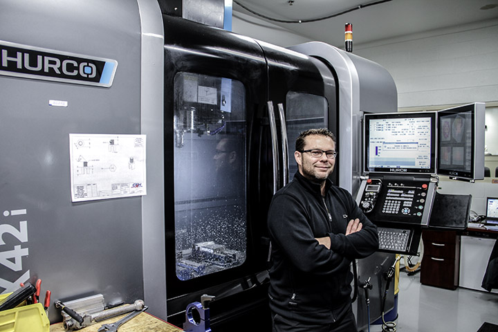

Robbie Ott, the head machinist at CFH Racing runs the machine shop. He discussed the transition to Hurco machines after we installed our flagship Hurco VMX42i mill and a TM8i lathe. Ott also elaborated on the possible benefits he expects when the shop adds the Hurco VMX42SRTi 5-axis machine.
