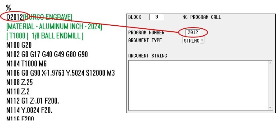

This document includes screenshots and instructions on how to use NC Merge with Patterns
NC Merge Block
Calling supplied NC Program
