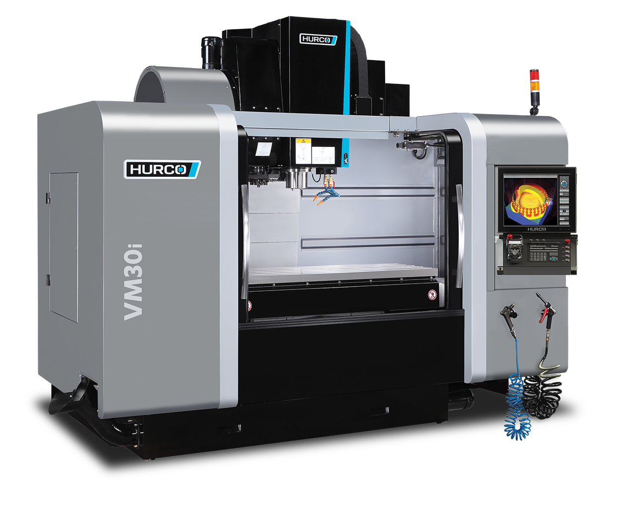

VM30i
3-Axis Machining Centre
The VM series of 3-axis machining centres features a small footprint with a large work cube. No other mill packs as much productivity into such an efficiently designed package.

Machine Specifications
Travels & Capacity
X, Y, Z Axis Travel
1270 x 508 x 508 mm
T-Slot Size5 x 18 mm
Max. Weight on Table1800 kg
Table Size1,321  x 508 mm
Spindle Nose to Table101.6 mm
Spindle
Max. Spindle Speed
12000 rpm
Spindle Power (peak - 1 min)15.0 kW
Spindle Torque (peak - 1 min)102 Nm @ 1450 rpm
Tool Changer
Tool Type
CAT/BT 40
Number Of Tools24
Max Tool Diameter 80 mm
Max Tool Length  250 mm
Max Tool Weight7 kg
Feedrates
Rapid Traverse X,Y,Z Axis
28 m/min
Max Programmable Feedrate25.5 m/minute
Size
Machine Weight4,245 kg
Machine Type3-Axis Machining Centre
Optimum machine performance is reliant upon installation conditions at the facility, such as power supply, air supply, and ambient air conditions. Information may change without notice.
